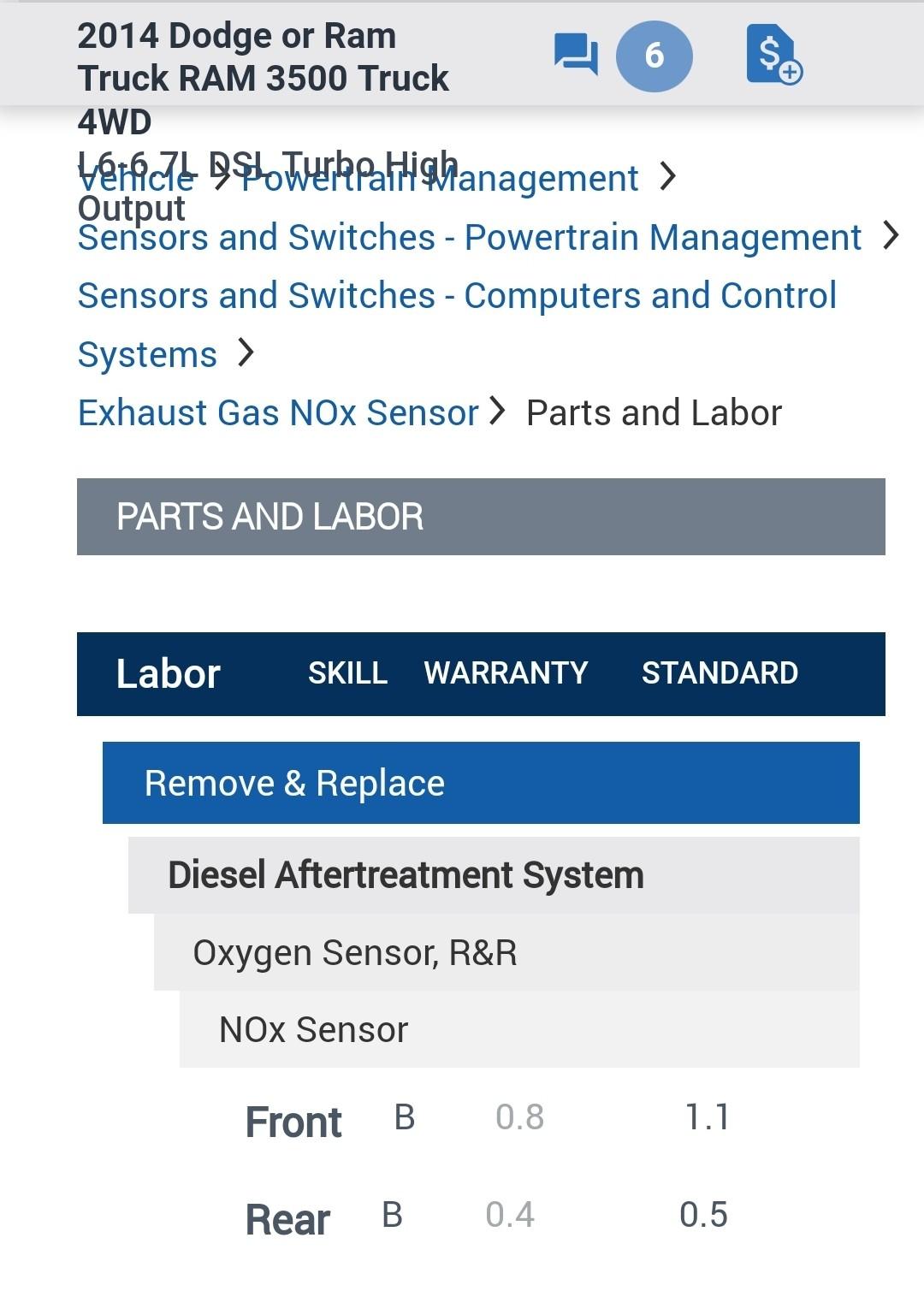

  8. Timd32 TDR MEMBER
    Late to the party here, but found the attached directions.
    You can always try again.
    I don't know the name of the cover where your tools are, but if you need directions on that and know the name I can look.
    I'm busy tomorrow but will take a look when time permits in case you need something else.
    Even for the pros says level B 1.1hr on this one.
    Screenshot_20220211-223032_Chrome.jpg #ad
    Timd32 , Feb 11, 2022
    #28

  11. Cummins2014
    This is all good information from you ,Mike ,and Tim32. I have been dealing with this sensor now for a couple weeks or so . So Mike it sounds like it's not necessary to get that bracket ,it just comes off ,and the new module bolted back to that ? As said in one picture online it showed the bracket ,whether it comes with it or not ,I don't know . Its the only vendor I saw that showed the bracket .It was an actual photo ,those red spacers showed on it .
    I have found several vendors for this sensor . I can get that part either from Cummins locally or on line, or a vendor on line for the Mopar , both are a Cummins product . Part # for the Mopar is R8210084AA. If bought from Cummins the part # is 4326873RX . They are all reman . Prices differ ,and if interested I can share all the prices , from Cummins is more expensive ,found one online for the Mopar which is very reasonable . All are subject to a refundable core charge ,the one I checked on ,they supply free shipping back on the core for the refund . Thanks all.

  12. Cummins2014
    Nice detailed instructions on that sensor . Thanks
    Cummins2014 , Feb 12, 2022
