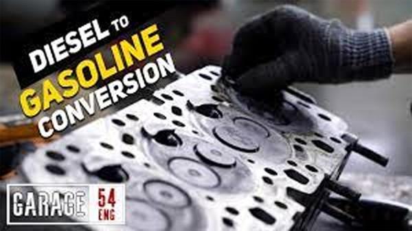

Are you wondering, is it even realistically possible to convert a diesel engine over to run on gasoline?
Yes, realistically possible but, not a quick or simple change. The folks at Garage 54, who have a growing reputation for pushing the automotive experimental limit, took on this madcap challenge in the video we’ve linked below.
If you understand the primary differences between a diesel engine and a gasoline engine, then you can imagine (in advance of watching this video) the challenges they faced for this venture such as:
· Lowering the compression ratio
· Adding spark plugs
· Adding a distributor and coil to ignite the spark plugs
· Lowering and stabilizing the air to fuel ratio
Now, take a look to see how this plays out. We hope you find this worth the quick 15 minutes to watch!
