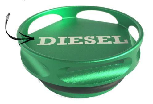

    Just a quick FYI. I had purchased one of the green fuel caps from genos for my truck last year. It worked pretty well but was definitely a bit tough to get it to seat correctly. After reading the article in the TDR by James Langdon (may have wrong last name) he had made mention of using a 0216 o ring on the cap and it fit great (I have no idea what cap he started with as it didnt say it was the genos one or not). In any case I just happen to remember reading that the other day when I was in the auto parts store and picked one up. It was like a $1. I swapped out the o ring and it did make quite a difference on the ease of getting it on and off. It fully seats now with just a little pressure and same coming off, much better.

  3. BarryG TDR MEMBER
    I guess you are right hadn't thought about that probably depends on who makes the cap as well and what size they are machining them, how deep the o-ring groove is cut on the cap etc. I guess I should reword my post to "on my cap from genos on my truck the 0216 ring helped it"

  4. wyosteve TDR MEMBER
    My cap from Genos fits snug which I like. I periodically spray a bit of silicone on the o-ring which helps in removing the cap.

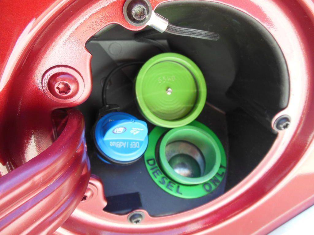

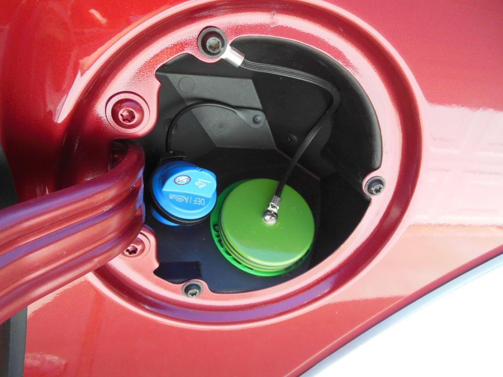

  10. GSykes TDR MEMBER
    This is the one I purchased from Genos. I like it because it fits down over the outside of the fuel filler neck not flush with the top. Works for me, no issues.

  12. masterdrago
    Are these new fuel caps really needed or are they just cool? My new Ram came with a 20 cent plastic cap that fits really tight. I think they spent the $$$ on important stuff like that awesome Cummins diesel motor. And hey, I sure wish we could have found our '17 in that Demonico red like that of GSykes!
