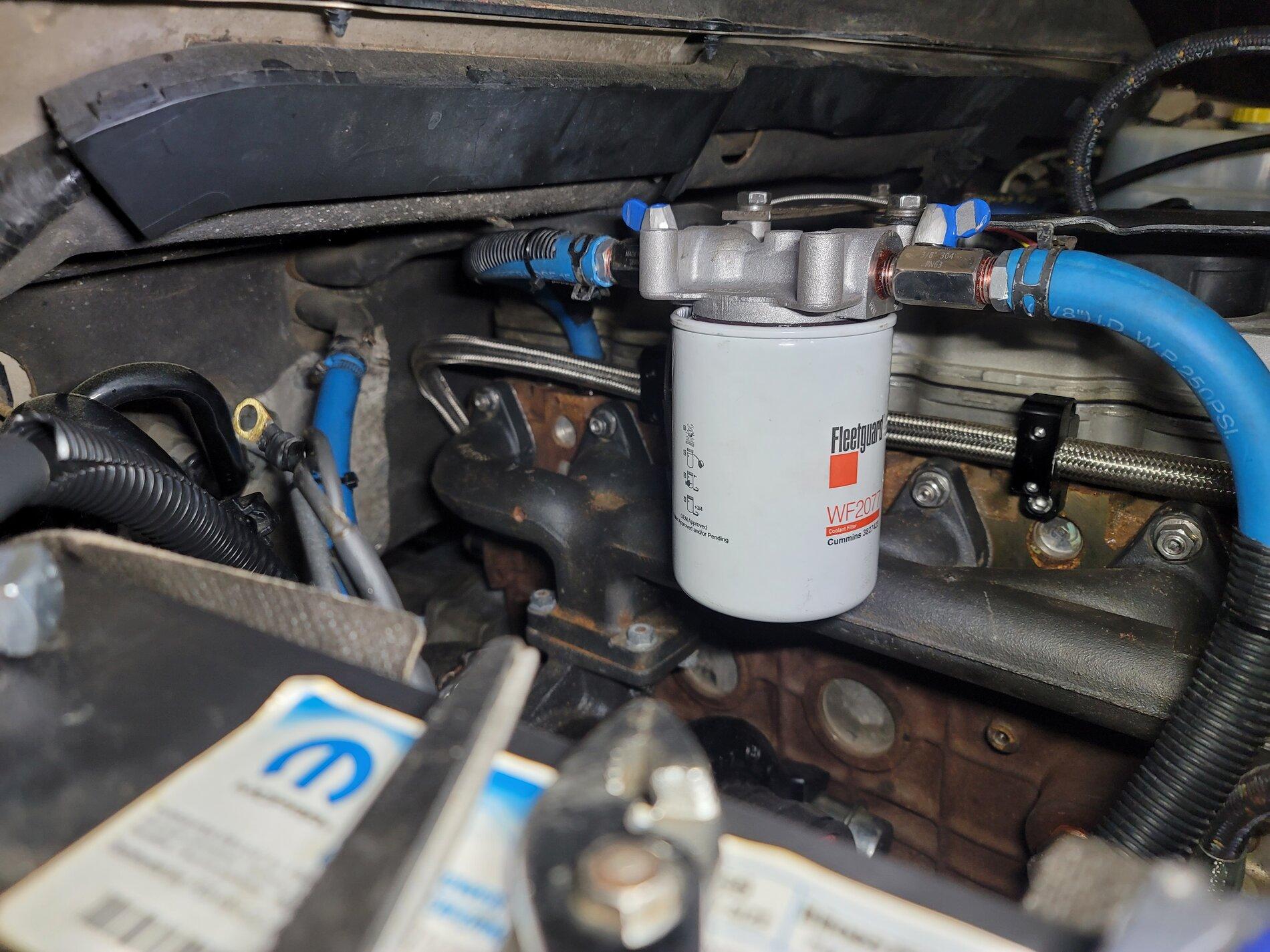

    My setup is in the engine bay above my manifold, you can mount yours where ever you have space. I didn't want to bolt anything to my frame and I was limited with my fabrication too a dead blow, some brackets, a cut off wheel and bolts/nuts.

    one fleet guard filter head 204163 S this ALUMINUM(don't go crazy with the torque) head has 3/8ths ports the filter threads on this port are 11/16th -16 UN-2B I used the WF2077 filters and one of their stratapore lower micron filters, Keep in mind you do not need any additive filters, untreated filters only.

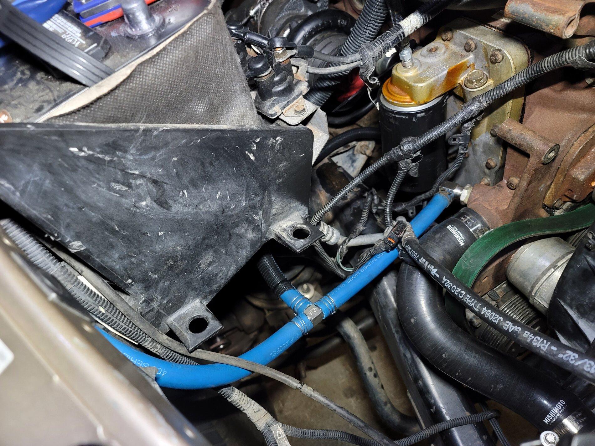

    Next get your 1/2 to 5/8 90* fitting, apply thread sealant to it and thread it in, make sure when you're tightening it down you know where you're going to route your hoses. I ran my hose around the perimeter of my fender going behind and underneath my battery box and up to the factory heater core hose outlet.
    trim the factory outlet hose, its molded for a shape, and install your 5/8 to 5/8ths barb union, run your hose from the factory outlet down to the lower coolant inlet.
    remove the rear most head plug for the coolant jacket, clean the threads, and install you're 1/2" to 5/8" barb fitting.
    Build your filter head and run a hose to the inlet of the filter head, measure out how much hose you need on the outlet to join the T fitting too the NEW heater core return hose.
    Install your T fitting on the NEW heater core return hose and join with the filter outlet hose
    top off and check for leaks.
